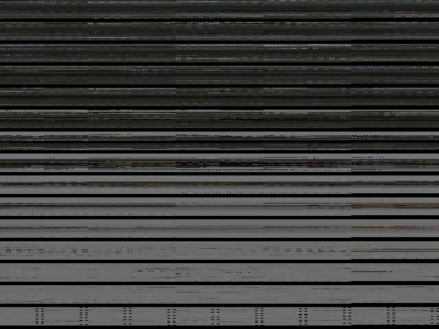

Reply 29 of 246, by Zebius
I upgraded my videocard recently and now I have Radeon HD3850 with Catalyst 7.12 drivers, system XP SP2.
Before I owned 6600GT and I could play TR1 with DosBox and Glide patch with no problems.
Now when I try to run a game using Dosbox version from gulikoza's site I receive following popup window:
'Severe problem: OpenGL GL_EXT_abgr extension is required for OpenGlide.'
It appears every time I try to load/save/enter menu, after any movies etc.
Also most of the time all I get trying to play is black screen (music and sounds are OK), sometimes graphics is normal. In DosBox status window I get many messsages: unsupported Glide call grErrorSetCallback.
I tried ykhwong CVS build but it crashes without any warning (exits to desktop) after introduction movies (in Glide mode).
Below is my OpenGLid.log after playing with gulikoza's Dosbox build.
Any hints?
Reply 30 of 246, by gulikoza
It seems ATi has removed this extension in 7.12 drivers!
But a quick check around the source doesn't show it is being used anywhere and TombRider still shows a picture here despite the error.
I will remove the check for GL_EXT_abgr, will see if it works better for you.
http://www.si-gamer.net/gulikoza
Reply 31 of 246, by Zebius
Thank you in advance. 😀
Maybe you wonder why I use DosBox with Glide patch instead of VDMsound and dgvooddo/Glidos for TR1? Simply I'd like to write an instruction how to run TR1 on Vista with DosBox for polish TR site. VDMSound doesn't work correctly on Vista so DosBox is the only free alternative to play this game.
Reply 33 of 246, by Zebius
I get no pop-up window anymore, but unfortunately this is not the end of my problems 🙁
After introduction movies most of the time I get messy picture (see an attachment), sometimes ring menu is OK but loading savegame gives me messy picture again. In fullscreen mode I can usually go back to normal visuals by alt-tabbing.
Sometimes the game just hangs in ring menu when trying to load a savegame. Sometimes I can see just part of the picture in lower part of the screen, the rest is black.
I tried all Dosbox output methods - ddraw, direct3D etc. both fullscreen and window. None of these options works flawlessly.
I also noticed two glitches - I can see many objects through the walls and there is no Lara's shadow.
I don't know what is the reason of this - shitty Catalyst drivers (as I said before on 6600GT I played for a while without major problems) or maybe glide patch needs correcting. Any help would be appreciated.
Thanks anyway. 😀
EDIT: Does glide patch support forcing resolution change? I can't go higher than 640x480.
This message: unsupported Glide call grErrorSetCallback still appears in status window. Do you need any logs or screens of status window to get more details?
Reply 34 of 246, by gulikoza
No, the wrapper has to support resolution change. One such wrapper might be available in a little while 😀
The grErrorSetCallback error is nothing to worry about.
One more thing you can try...try using dgVoodoo glide2x.dll. You can also try setting it to Direct3D9 renderer. Seems opengl is pretty broken on 3850 😜

Reply 38 of 246, by Zebius
I've made more tests with TR1. I'm able to run it in window usually but it crashes from time to time when loading a game or starting a new one.
Also I tried other wrappers:
- dgvoodoo 1.50beta and beta2 works but it's unplayable due to lots of artifacts (lines, transparent walls etc.)
- psvoodoo crashes after intro movies or gives black screen with music in background
- zeckensack's wrapper crashes after intro movies
I give up, I'll stick with XP anyway where we have VDMsound working very well with TR1.
Reply 39 of 246, by gulikoza
Wait...you use Vista? Must have missed that 😀
Did you try setting SDL_VIDEODRIVER=windib? But it's true, I haven't tested my patch in Vista since I don't use it...
