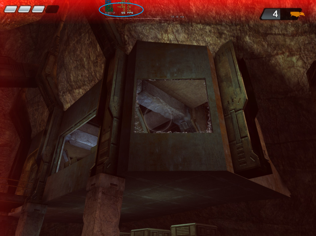

About the memory leak: just play the very first part of Reservoir, dying some times (4-5) after killing the soldiers and destroying the glasses.....(the glass shaders are the culprit?) of the gondola control room.
I got this:

I got this:
Damn, it's reshade on top. With NO shaders loaded it can somehow devour the VRAM nonetheless.
Will try in D3D11 and D3D12+"d3d12.dll" and not dxgi point of insertion.......
Edit: I can confirm it's a D3D12 issue only, no problem with D3D11+ReShade.....

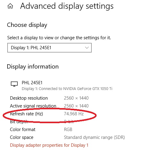

Reply 145 of 474, by lowenz
74.99!
The log shows that if I set "75" in the ini dgVoodoo2 sees 59

Reply 146 of 474, by lowenz
Here's the value!

Reply 148 of 474, by Dege
Thanks, then I think I understand what happens: dgVoodoo gets the supported refresh rates from DXGI in rational form (e.g., my 75.025Hz is described as 135000000 / 1799408), and converts them into integers by truncating (DX8/9 don't support rational form), which is 74 in your case. So, you specify 75 to no avail because UE doesn't see 75 Hz as a supported refrate and it chooses another (default or first enumerated) instead.
How to convert rational into integer (trunc or rounding) was a question here previously and I chose truncating not to mess with 59/60Hz.

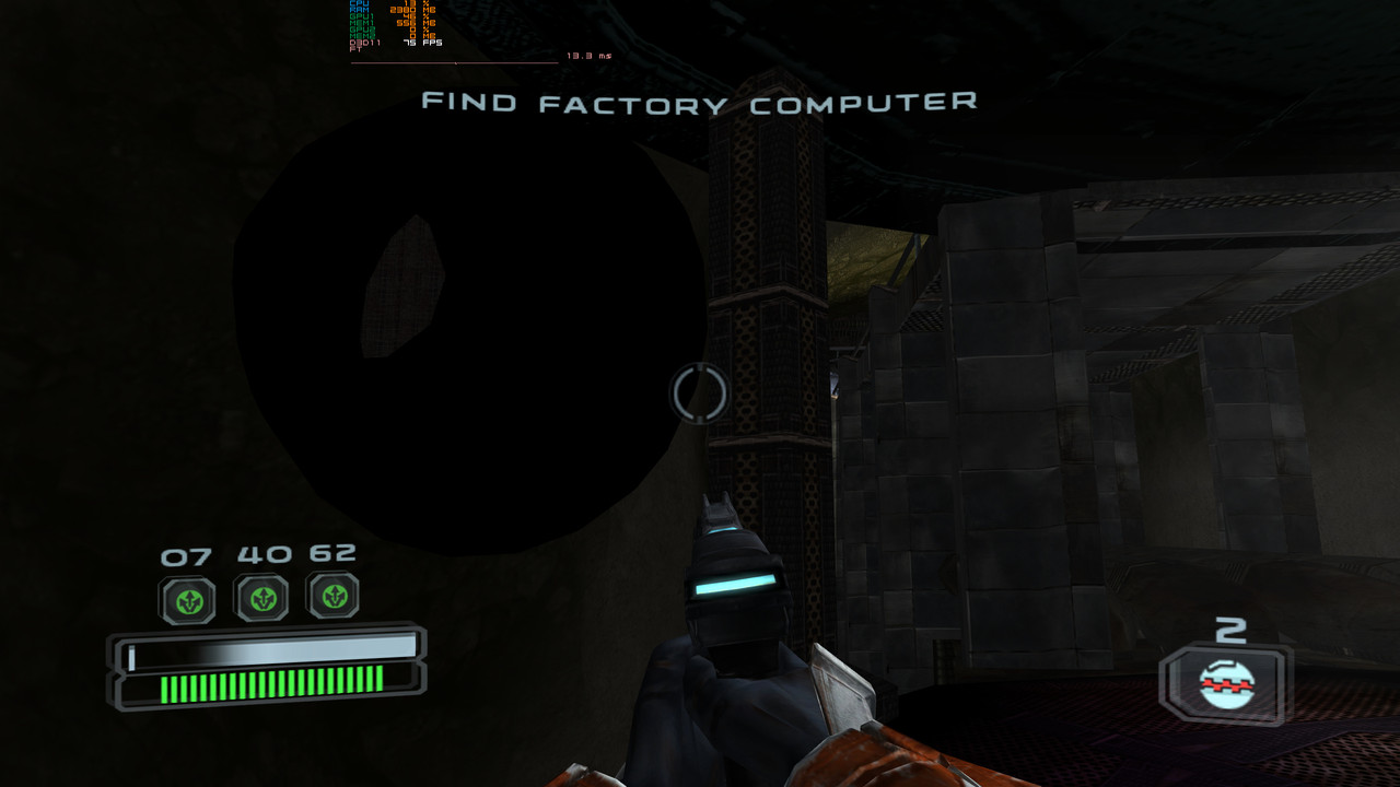

Reply 150 of 474, by lowenz
Republic Commando texture (bumpmapping?) issue:
(Droid Factory Enter, not using any fix, only dgVoodoo2)

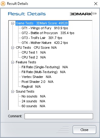

Some 3DMark03 results (1920x1080 / MSAA 4x / AF 16x)
No wrapper:
D3D12 wrapper:
Maybe the -20% in Proxycon is related to the shadow system?
