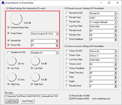

I find the bass to be much stronger on the X2GS and by default the reverb is much stronger too - I recently cut the reverb in half because it was too much for my retro 2.1 speakers and it sounds more like a SC55 to my ears now. I'm not even close to an expert but I've owned both an SC55 and an SCC-1, and I prefer the X2GS. Similar sound but a bit more "lively", or something.

For someone who just plays games, what's the best way to tweak the reverb on bootup, or before playing a game?
Reply 118 of 309, by badmojo
Not sure about what's best but I used the provided tools to dial back the amp output and reduce the reverb as global settings. There's a whole lot of GS resettable options that I haven't investigated yet but I just play games too, so I don't want to be messing around with stuff on the fly.
