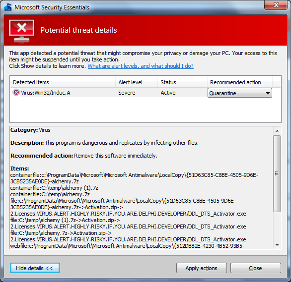

What's with the virus alert warning for the activator?
Indeed, Microsoft Security Essentials finds this:

And it's right indeed. One of the included tools was affected by Win32/Induc.A infection.
If you had read my previous post (or the included readme) you would be already aware of the issue, and you would already know that this should only have been a problem for delphi developers.
I just included it for completeness, since it was the only one that could work on VMware emulated windows XP (with monitor_control.restrict_backdoor=TRUE but that's another story).
But I find out that even another version works, so I removed it.
The archive should now just triggers some warnings about obfuscation (if any), only on some fussy AV
Let me know if there are other problems

I am not sure if it is a smart idea to leave the attachment on the board.
Some virusscanner url checkers actively block sites that have files with virus infections. (so users with that virusscanner can't access the board)

Now it should be better. I removed the blatantly infected file.
Hopefully this will be enough.
