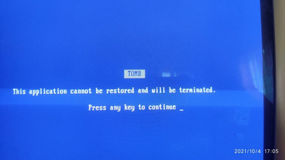

Hello,
I am trying to run TR1 using Glidos on win 98 but seem lost. In the Glidos page, the link for the instructions for Win 9x is broken. Also I was unable to find a thread related to this here. Could some one please help with the steps to run this game on Win 98? Thanks.
Intel 845GEBV2, Pentium 4 2.4 Ghz, Geforce FX5600 256MB, 512MB RAM, 160GB HDD, Sound Blaster Live! SB0100 - Win 98/XP

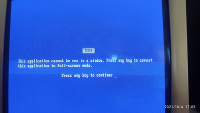

Thank you all. I downloaded the 1.29 version and it worked perfectly for TR and TR UB. However for UB alone, I was getting a spinning Glidos logo right from the start. So I proceeded to install the unlock code for the Glidos ID using the free account provided. After installing the 4 liner keys, restarted Glidos. Then when I proceeded to run TR/UB, I was getting blue screens as below despite the game being set to run in full screen:
88.46 KiB
2339 views
86.09 KiB
2339 views
After pressing Esc, the game exits abruptly. Please let me know how to fix this error. Thanks.
