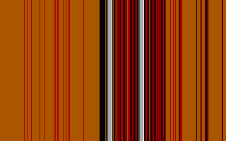

Here is a fix that will help you if you're trying to run Crystal Caves and/or Secret Agent on a real DOS PC and the display is only showing you vertical lines that stretch from the top of the screen all the way to the bottom, like in the following screenshot:
608 Bytes
2763 views
Copy the following script and save it as a plain text file. Then get my patching utility and open the text file with it. Follow the instructions to patch the games' executables.
Note that there are at least two slightly different versions of CC1.EXE floating around. Both versions are supported by this patch, so it is completely normal to get one error message saying that the size of CC1.EXE doesn't match during the patching process. If you don't have all of these games, simply click "Cancel" when the program asks you to open an executable that you don't have. The program will continue with the other executales in the script.
This patch script will work on version 1.0 as well as version 1.0a of both games (1.0a is really just a hacked up v1.0, where two bytes have been changed to prevent the game from setting the date back to the 1900's).

Reply 2 of 3, by firage
This patch has fixed the games for the ET4000/W32p. Crystal Caves and Secret Agent compatibility was really the only issue that bothered me personally about these video cards previously. Very happy now - thanks again K1n9_Duk3!
(The first Apogee title screen will look more like a black screen with just a few stripes, just because there's a lot of black on that one line it draws for the entire screen. So the example shot here has a little more color going on than the bug will show at first.)
